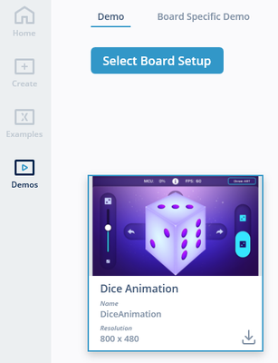

I would recommend you to have a look at the Dice Animation available in TouchGFX Designer in the Demos tab.

Yes, DiceAnimation works on the STM32H7S78-DK, I used the 16bit depth (lower image quality) and the maximum CPU usage is 14%, for now it is enough to know that this platform can works with pseudo 3D,quite big object and 60FPS. For me 30FPS or even 25FPS is lowest limit so rather I will try do more in near future.
