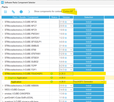

You have this issue because you haven't selected TouchGFX for Cortex M7 I believe.

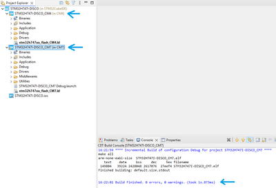

I started a project with a TouchGFX designer and tried with a TBS board (STM32H747-DISCO) and didn't face any issue when using .project.
It already contains both projects CM4 and CM7 when you open it:
Both projects (CM4 and CM7) compile fine.

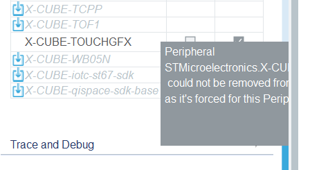

from MX access to create a new project, the MX' select item is total different, touchGFX can't place under M7, it be forced to M4!
moreover, many places cannot be reselect. don't know how to utilize M7 by MX, many select items be force under M4, how to do, is there a switch to do, to turn M7 from M4!?

following your guiding!
Now can select CORTEX_CM7 item, when setup TouchGFX!
thank you again!
