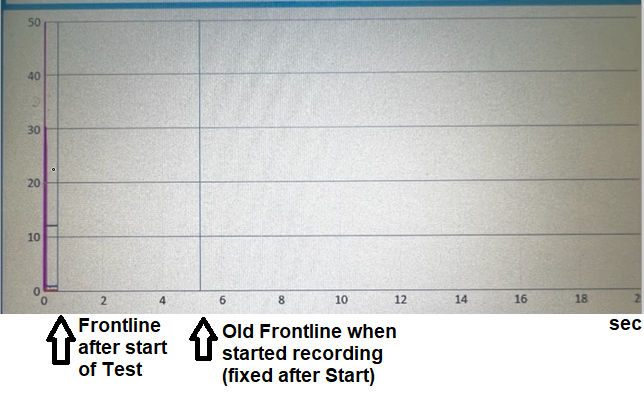

I am using the Dynamic Graph to display incoming data over time. The frontline moves forward on the x-axis as expected.
Then the user presses the Start Button to record the data, I clear the graph and restart at 0. The vertical frontline also restarts from position x.
BUT: the previous frontline position is not removed in the graphics and stays there as a vertical non-moving line until the current frontline overwrites it.
How can I remove this "old" vertical frontline?

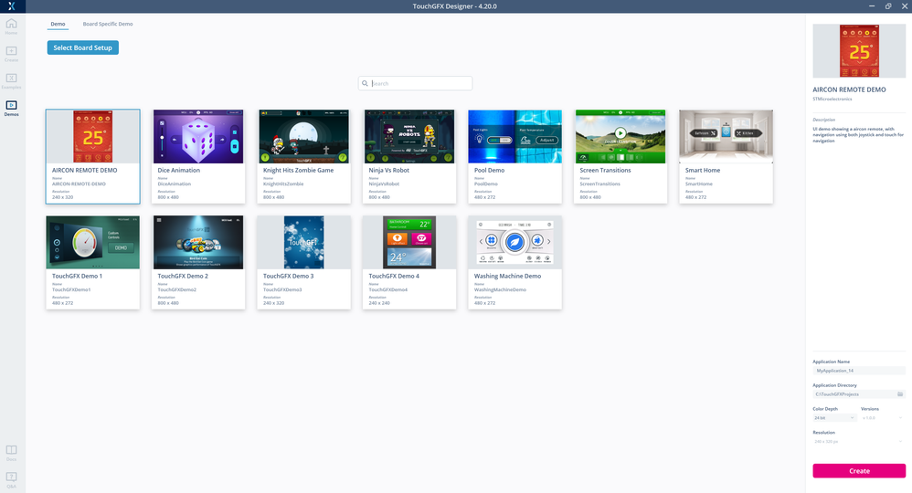

2022-11-23 12:30 AM
There is the Aircon Demo that can help you understanding how to use HW buttons on your board. Please have a look at that :
/Yoann
