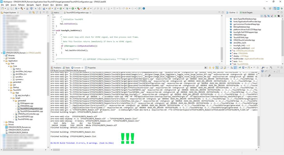

The bullet method above works and compile perfectly fine if followed to the letter (thanks x100). Quite different from what I used to be doing, which was creating a new project out of STM32CubeIDE and dbl-clicking on the ApplicationTemplate.touchgfx.part from STM32CubeIDE itself and working my way in TouchGFX and STM32CubeIDE solely. I swear this used to work before, never had to use MX until today.
MX. So be it. Thanks for sharing The Official Method of getting a blank project init and compiling.

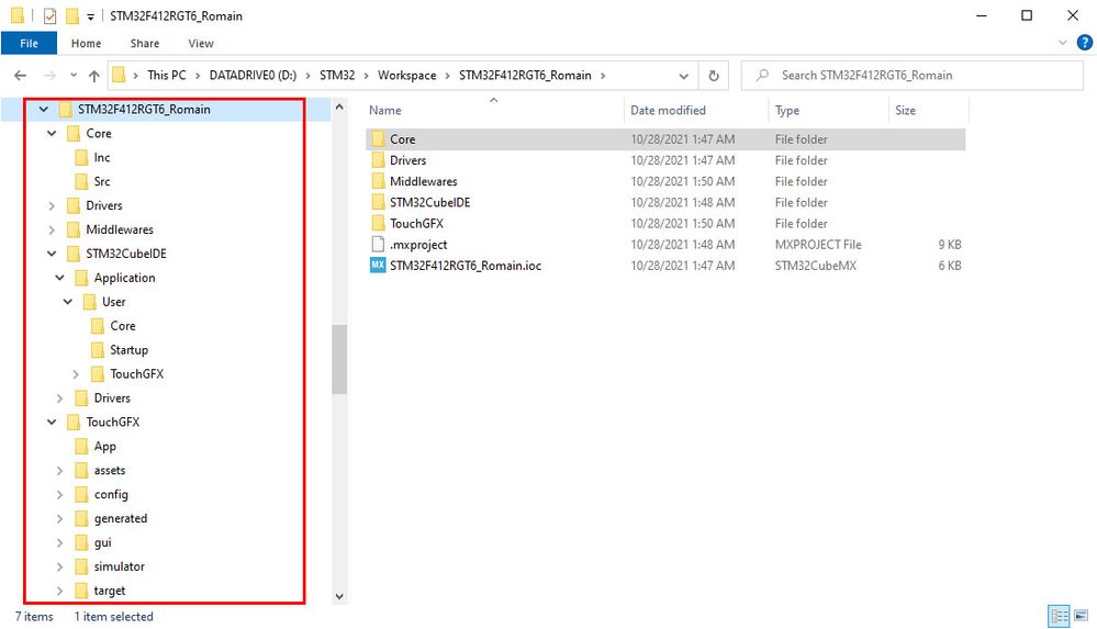

One last thing; can you please confirm that the resource tree (files/folders generation) is up to spec on the visual below, see circled in red. If this is all dandy I'll therefore employ your method for all new projects and circulate the info around so we're all on the same folder-structure here.

pps. notice the Videos.s not interfering when using your method. That said it may be a user (myself) error more than a bug as initially reported.

And yes the folder structure is what you should expect/have.
