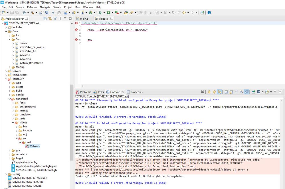

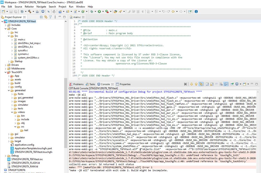

Hi, I've just managed to get 4.18 to show into STM32CubeIDE and fairly happy about that. However quite shattered to find out that some of the same 4.17 bugs remains... among a new one that is new to me (Videos.s). All in all, the default generated code does not compile and consequently makes TouchGFX unusable. Quite unfortunate.
Anybody had any luck getting around the now old 'touchgfx_init' and 'touchgfx_taskentry' bugs?
ps. the videos.s bug (1st screenshot) can somehow be fixed by simply deleting the entry from the resource tree.

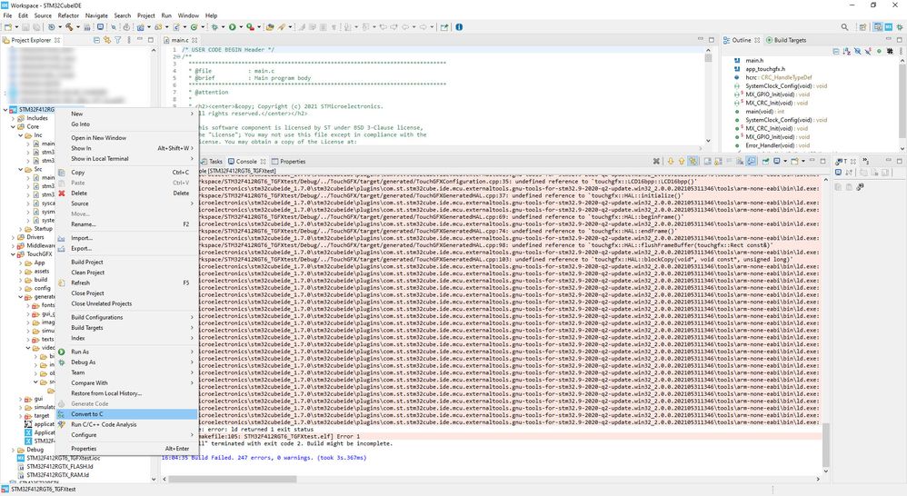

From the steps you shared I am unsure if you started your project from STM32CubeIDE or from STM32CubeMX ? Could you right click on your project in the tree view in STM32CubeIDE and see if you have an option called "Convert to C" ? If not it would be called "Convert to C++" which means that your project is not a C++ project, where TouchGFX will not work. Those errors 'touchgfx_init' and 'touchgfx_taskentry' indicate that, but it might be something else.

Concerning the Videos.o issue, if you look at the error message you can see it is located in a Keil folder. Since you use STM32CubeIDe you can remove the library path and delete that folder (it is automatically generated by TouchGFX generator in case you use Keil one day. But to be honest this is an error from our side it should not be always generated, but only when using Keil. Thanks for reporting this it will be fixed in TouchGFX 4.18.1).

Edit: I started the project out of STM32CubeIDE
I confirm that I had the option to convert to "Convert to C++", and which I've done however made things far worst for some strange reason I can't figure out (see visual). Let me see if I can replicate this with a New Project set to C++ from scratch. And while at it I'll try your MX recommendation too. Let's see...

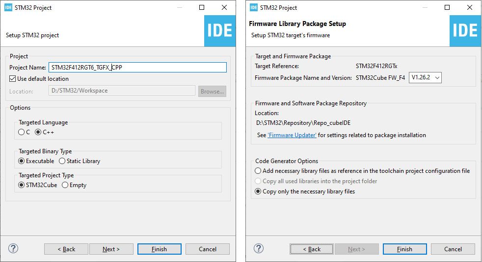

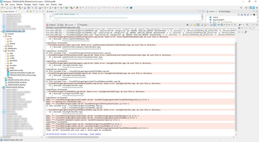

Here goes the trace for a New Project from STM32CubeIDE 1.7.0 and TouchGFX 4.18.0 set to C++ as targeted Language. All pretty funky stuff...

Yes unfortunately this is a STM32CubeIDE error, and not a TouchGFX error so we (the TouchGFX team) cannot fix it.

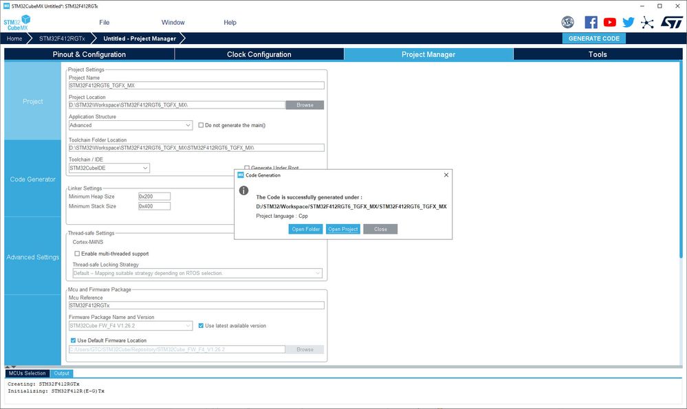

2021-10-27 2:39 AM

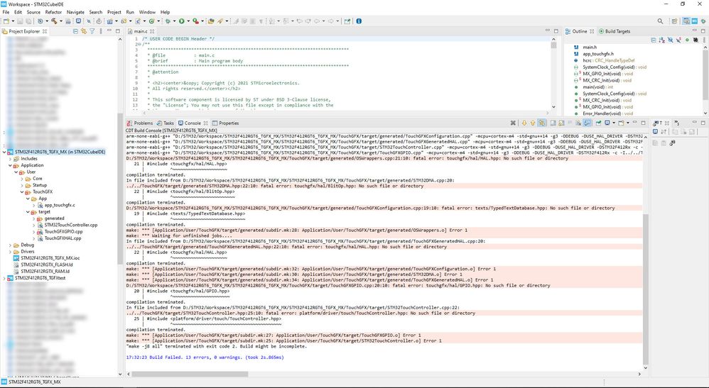

Here goes the trace for a New Project from STM32CubeMX 6.3.0 and TouchGFX 4.18.0 and then Opened into STM32CubeIDE 1.7.0
"ApplicationTemplate.touchgfx.part" does not come up, project does not build, errors, all of that recurrent good fun!
As you can see nothing really works anymore, and that since Version 4.16.0 to my limited knowledge.
Wait a few more months hopefully in anticipation that these bugs eventually gets picked up by the ST's devs?
