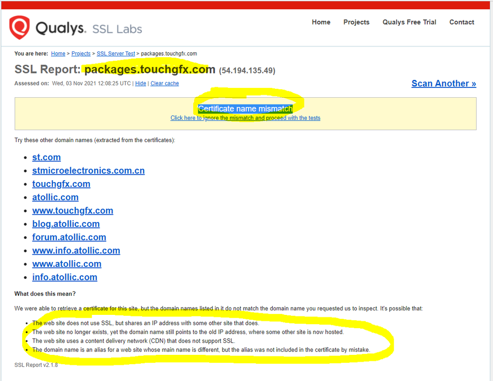

with TouchGFX Designer 4.18, a proxy dialog with username/password appears, but according to my local IT it is not possible to connect with packages.touchgfx.com because SSL certificate has expired.
https://www.ssllabs.com/ssltest/analyze.html?d=packages.touchgfx.com
Can you please renew your certificate?
Thanks.

According to my local IT, our proxy rejects connection to packages.touchgfx.com because SSL certificate has expired.
https://www.ssllabs.com/ssltest/analyze.html?d=packages.touchgfx.com shows "Certificate name mismatch"

https://www.ssllabs.com/ssltest/analyze.html?d=packages.touchgfx.com still shows "Certificate name mismatch".
According to my local IT, this is the reason why our Proxy blocks access.
Can you please fix this issue?
