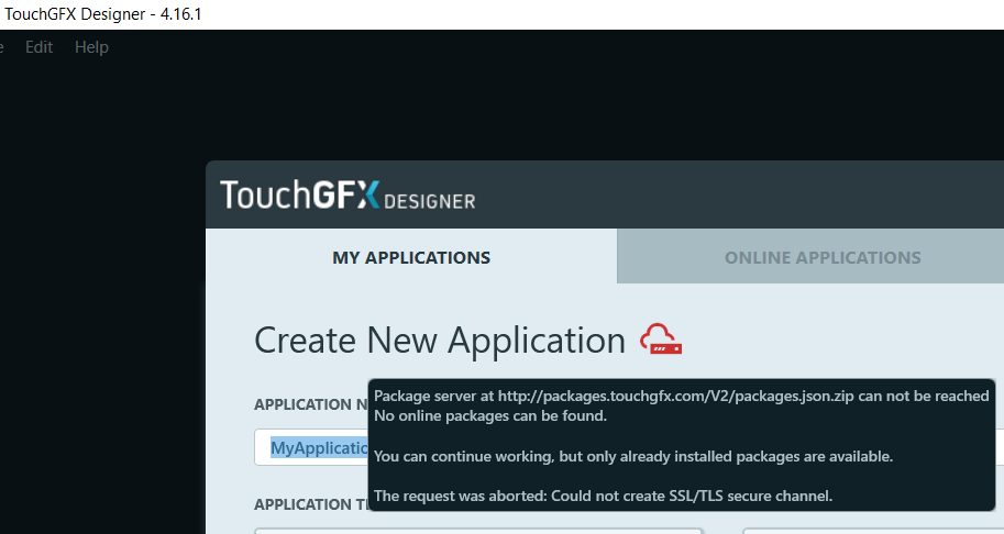

2022-01-19 7:16 AM
Unfortunately this problem has been persisted now for 6 months. I have tried to install 18.1 and then 16.1 but with no luck. I do not have existing installation since I have changed my computer several times. I know some IT departments are slow but 6 months....
Below I have screen shot from TGFX 16.1, which tells that I have no access to packages.json.zip on packages.touchgfx.com site. Which is correct since either ping nor traceroute could not find the site. So the problem is not the operating system or its version but the server. There is no longer any site called touchgfx.com. Its forwarding to st.com site.
This situation is sad because the program itself is excellent in its field.

2022-01-28 12:54 AM
I've just noticed that this forum page connects with TLS 1.2. I do not see why the demos served to TouchGFX Designer need to connect with TLS 1.3. It seems absurd to enforce such a strict standard for demos and not for the rest of their web services.
