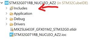

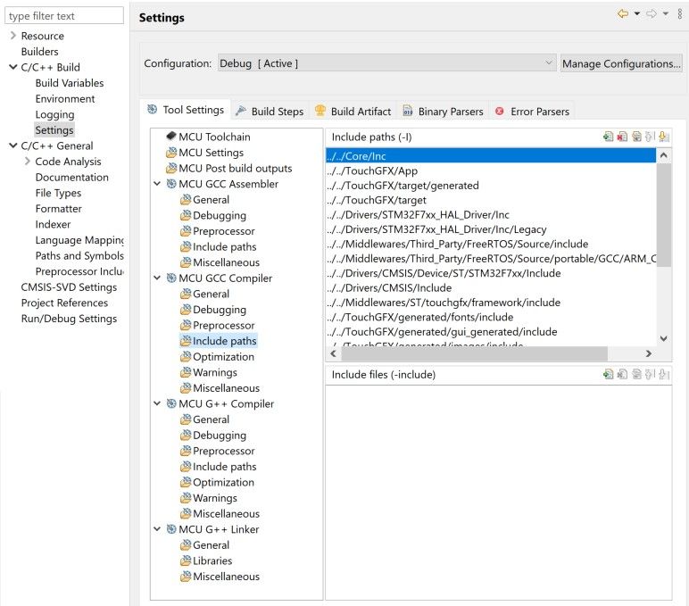

For your second issue, the header files should be under the Includes section and then you will see a list of all the include directories that are specified in your project settings. So if you don't see the list, please check that the include paths are defined in your project properties -> C/C++ Build -> Settings -> Tool Settings -> MCU GCC and MCU G++ -> Include Paths.
Includes
Include Paths
