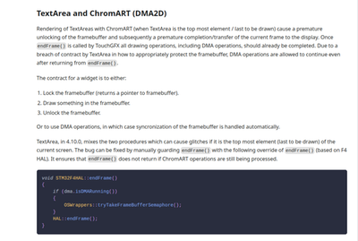

I found similar scenario under "known issues" in the Documentation, under v4.10.0 issues ( https://support.touchgfx.com/docs/miscellaneous/known-issues :(
But the proposed solution didn't work for us, as `dma.isDMARunning()` is never "true" at this moment.
