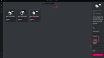

As a rule of thumb, always use the latest versions if you can. So for TouchGFX, STM32CubeMX, STM32CubeIDE, etc.
Since you use a Riverdi board, here are the steps to be able to flash your design on your board:
Then you can import the GUI you previously created by clicking on "Edit" => "Import" => "GUI".
If you have done those steps and you get the error messages mentioning flushline and DecompressorRGB, simply open your folder, open the STM32CubeMX file (.ioc) and click on "Generate code" (make sure to use the correct toolchain such as STM32CubeIDE for STM32CubeIDE or TouchGFX Designer).
Then you can flash again and the issue will be gone.

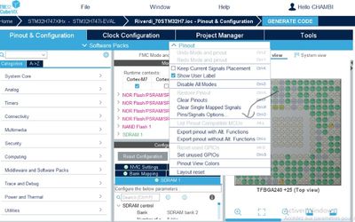

Hello @Aziz ,
If you created your project from TouchGFX Designer by selecting your board+display combo, then you can try to open the STM32CubeMX project (.ioc file) and click again on "Generate code" (make sure to have the right toolchain selected [STM32CubeIDE for TouchGFX Designer] and do NOT generate under root).

2024-08-08 5:00 AM
I open cubemx and i haven't access to it .Also the type of card selected isn't the mine my card is nucleo stm32h7a3ZITQ

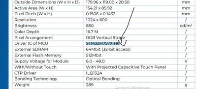

after i deleted libjpeg-8.dll, SDL2.dll, SDL2_image.dll, simulator.exe and i didnt generate or simulate the code again i run target direct and the error message at first appeared
Now i change the version of STM32CubeMX 6.12.0 to 6.5.0 and the IDE from 1.16 to 1.8.0 and i ll try it
2024-08-08 6:58 AM
the display i use is Riverdi_70STM32H7 i have riverdi 7"
