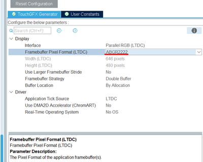

I see I can not select a Frame buffer Pixel Format (LTDC) which would make Touch Gfx to write on frame buffer with a 8 bits grey scale format.
I selected ABGR2222, in order to test and see what happened.

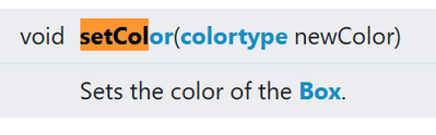

You use the function box.setColor().

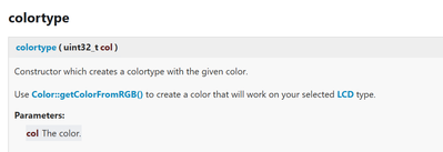

This functions takes as argument a colorType:

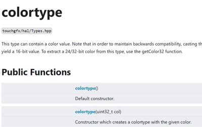

The colorType takes an int 32 :
But you only feed values from 0 to 255 which is ARGB8888.
So I would assume you are only changing the last part of the colortype, therefore only increasing the blue part of the display, but after blending with the other colors and after your screen also makes his transformation to go from color to grey (because it can only show grey), you get only a limited range of grey that goes from dark grey to black.

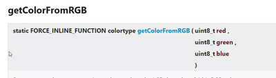

To do so, you could call getColorFromRGB inside your colorType:
And set all the colors to the same value:
