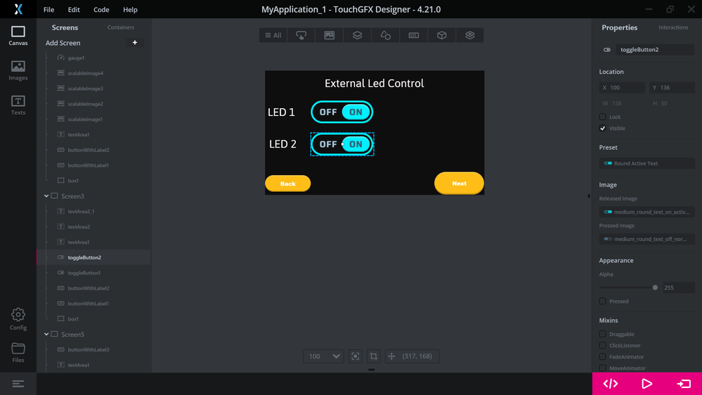

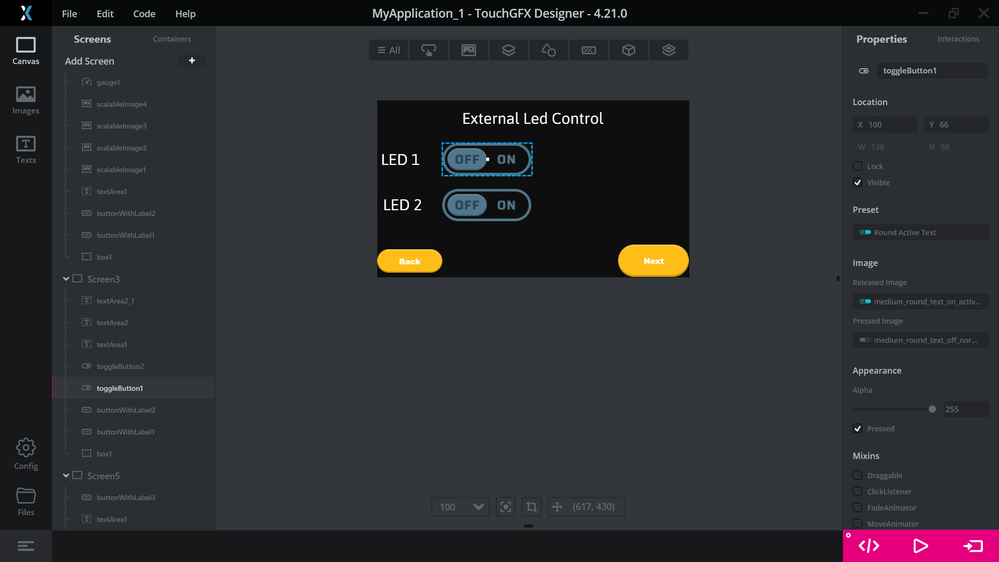

2023-01-11 11:42 PM
if i will change this codition to "off" state during program excuation it will change to "off" .but when i change screen to another screen the position is came to starting point "on".
how i solve this ?

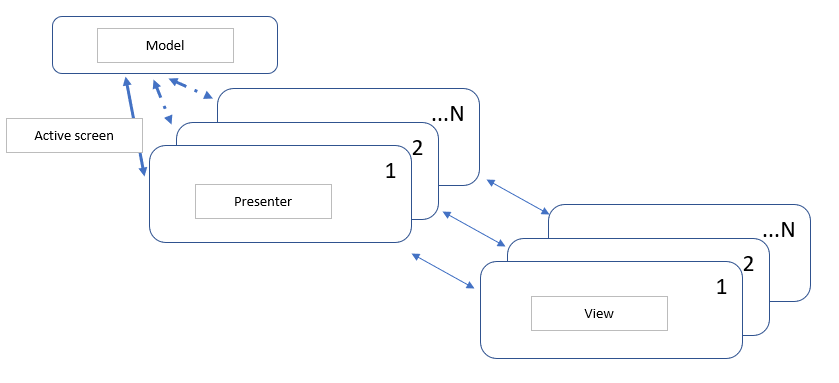

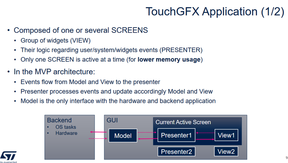

Hi @Yoann KLEIN ,
I started to use TouchGFX few days ago and it took me a while to understand that there is only 1 Model for the whole GFX (I come from Qt world so had to readjust to GFX's use of Model concept). I think it would help a lot if this was emphasized in docementation a bit more eg:
Or as it is done in this document:
