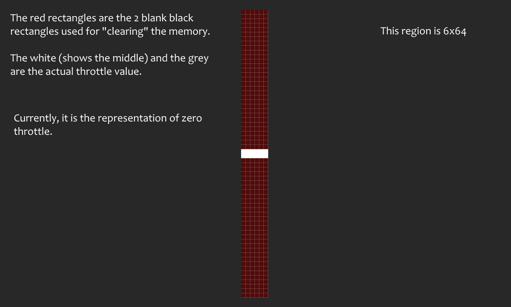

I am using a bitmap array for the black and white rectangles. The size of the black and white rectangles is 6x56 pixels. In my case, one row is made up of 3 bytes, which means that every size has to be a multiple of 3. This is the value that I am passing into the writeData2 function.

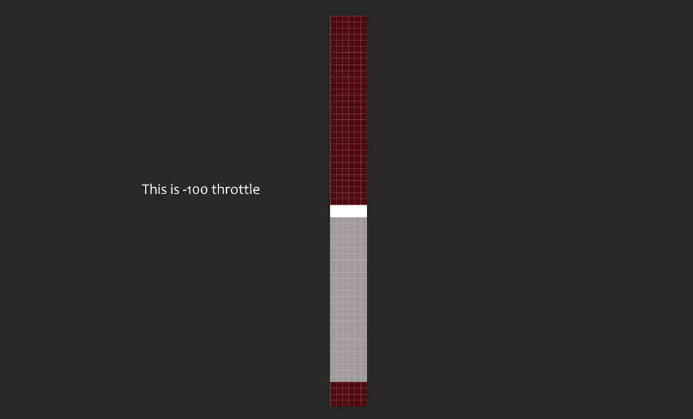

So far I have made something to solve this but it doesn't really work properly. I split the incoming data into 3 cases, when the throttle is above zero, under zero and of course when it is zero. For the sake of simplicity I am showing the code only for the positive region.

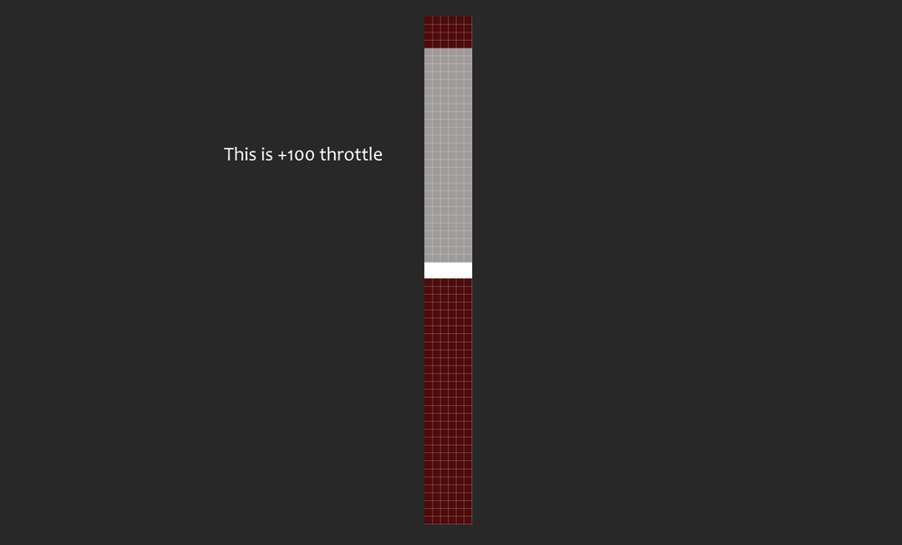

The positive case uses 1 black and 1 white rectangle. I am controlling the start and end position of the rectangles and their size respectively.
At 0 throttle the black rectangle spans from 0 to the 30th row, and the white rectangle is just one line in 31.
At 100 throttle the black rectangle spans from 0 to 3 and the white rectangle from 4 to 31.
