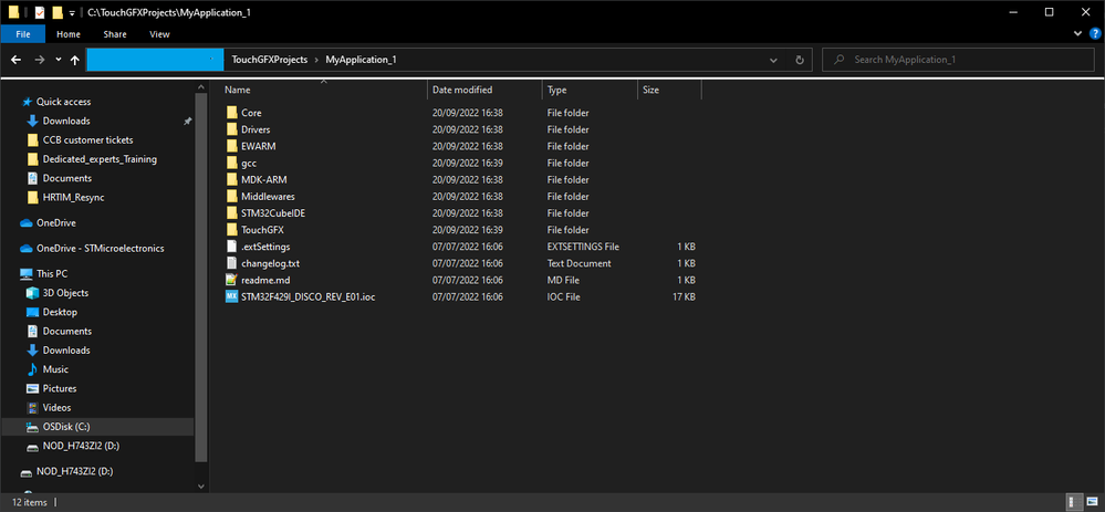

As @Pavel A. mentioned SW4STM32 is an old tool and the CubeIDE took it's place.
So in your case you will be needing STM32CubeIDE, STM32CubeMx in addition to TouchGFX.

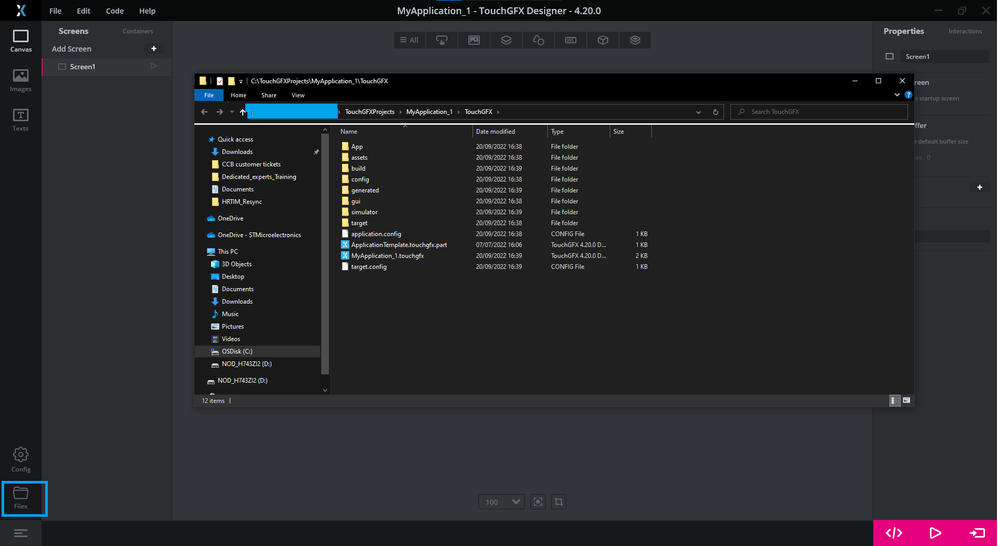

In addition if you start your project from the TouchGFX tool it will generate an *.ioc file and an STM32CubeIDE project.
In the TouchGFX UI click on "Files" and it will open the TouchGFX project location.
Go a level up in the in that path and you will be able to find the *.ioc file and the CubeIDE project folder.
PS I am using TouchGFX 4.20, CubeIDE1.10 and CubeMx 6.6.1.
Kind regards,
Semer.
