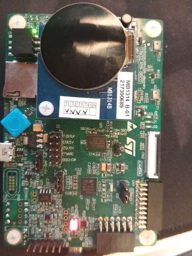

Hi ,@Martin KJELDSEN
Thanks !!I have downloaded hex into my application template,but it can't run.The following this picture is screen is not running.The code is as follows.
uint8_t *framebuffer = reinterpret_cast<uint8_t*>(touchgfx::HAL::getInstance()->lockFrameBuffer());
for (int y = invalidatedArea.y; y < invalidatedArea.bottom(); y++)
for (int x = invalidatedArea.x; x < invalidatedArea.right(); x++)
for (int i = 0; i < 3; i++)
framebuffer[x * 3 + i + y * 3 * 390] = code->at(x / scale, y / scale) ? 0x00 : 0xff;
touchgfx::HAL::getInstance()->unlockFrameBuffer();Could you help me to see what's wrong ,and how can i solve it.(Ps:I add a box widgets which is blue in middle screen )
Thank you very much!!!
Jack li
2019-02-22 5:00 AM
Does it work when your framebuffer is 16bpp?
2019-02-22 10:12 PM
When i use stm32f429-disco which framebuffer is 16 bpp,it works properly .
