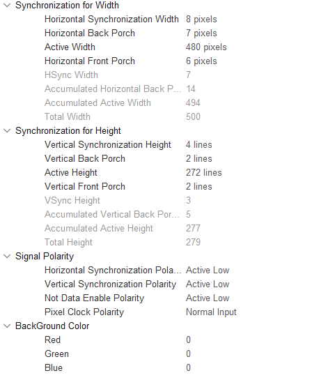

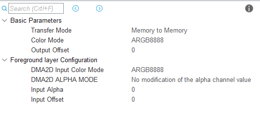

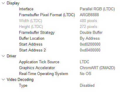

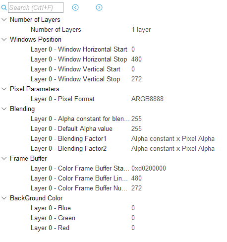

Settings from my CubeMX project:
DMA2D SettingsLTDC Layer Settings
LTDC Parameter settings:
TouchGFX Generator Settings:

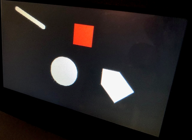

I made a little demo screen as I'm not sure I want to share my application UI. See screenshots below
Simulator.
Target LCD (sorry for the poor quality). Only the "box" widget is red.

I think we've identified what the issue is but don't know how to solve it. It looks like the Canvas widgets are utilizing byte writing to the external RAM where our current setup does not support byte writing, only word writing.
I put a breakpoint for when 0xD0400020 and 0xD0400021 are written to. This location is in the frame buffer, and that pixel should be part of a Circle widget, color #1949E6. You can see in the first row the E6 byte is written to the first byte, then when the second byte is to be written, 49, the first byte is overwritten with FF. This is why we see white instead of the correct color.
We are using the STM32F429IIT micro, which unfortunately shares the FMC_NBL2 with LTDC_B4 (pin PI4). We are using a 32-bit external RAM and a 24bit TFT LCD. The FMC_NBL2 pin is one of the masking pins used to use byte writing. CubeMX even recognizes there is a conflict.
Is there something we can configure or change for the Canvas widgets to use word writing to the frame buffer? What are other options we can explore?
2022-02-07 1:21 AM
Maybe try to use the XRGB painter. They use only 32-bit word writes while the ARGB8888 painters use byte writes.
/Romain
