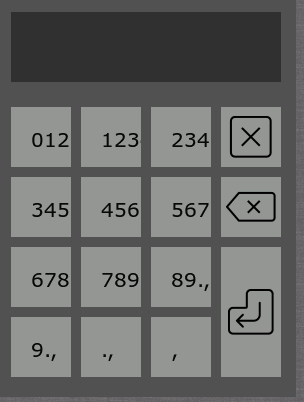

Apparently, my message wasn't as clear as I thought… I'll examplify a bit what I meant:
Instead of seeing this:
std::array<touchgfx::Unicode::UnicodeChar,15> _test;as a single buffer, called test, holding 15 different elements, you can see it as an array containing 15 buffers, each holding a single element, right?
But this obviously doesn't work:
aKey->setWildcardTextBuffer(&_test[i]);As the function doesn't know the size of the buffer (it believes it's just a 'standard' buffer), and therefore, you get something like this:
I hope I made my point a bit clearer :)
2019-05-24 5:20 AM
TouchGFX operates on strings of Unicode chars. The strings need to be escaped with '\0' - So your buffers should all be of size 2.
