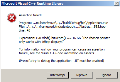

I'm working on a project on the STM32F746G-DISCO board, a colleague modified it to be used in kyle and succesfully be loaded on bord, and now when i launch the simulator via touchGFX designer, everything seems to works fine, but when i launch it from visaul studio i have this when i open one of my screen(yes, just one, the others works fine)
should i modify something from cubeMx?

This is probably because your project uses a 16bit painter for a Canvas widget, but.. the bitdepth of your application is actually 24 - And does not match. Please check the following file in the root of your application for the <useBPP> :
config/msvs/Application.props/Martin
2019-06-11 4:08 AM
Here's an example from a default configuration made with CubeIDE - So, basically you can could be linking with various combinations of objects that match a certain bitdepth but some configurations do not work, hence the asserts. e.g. If you were to use an RGB888 painter with LCD16, that would not work either.
