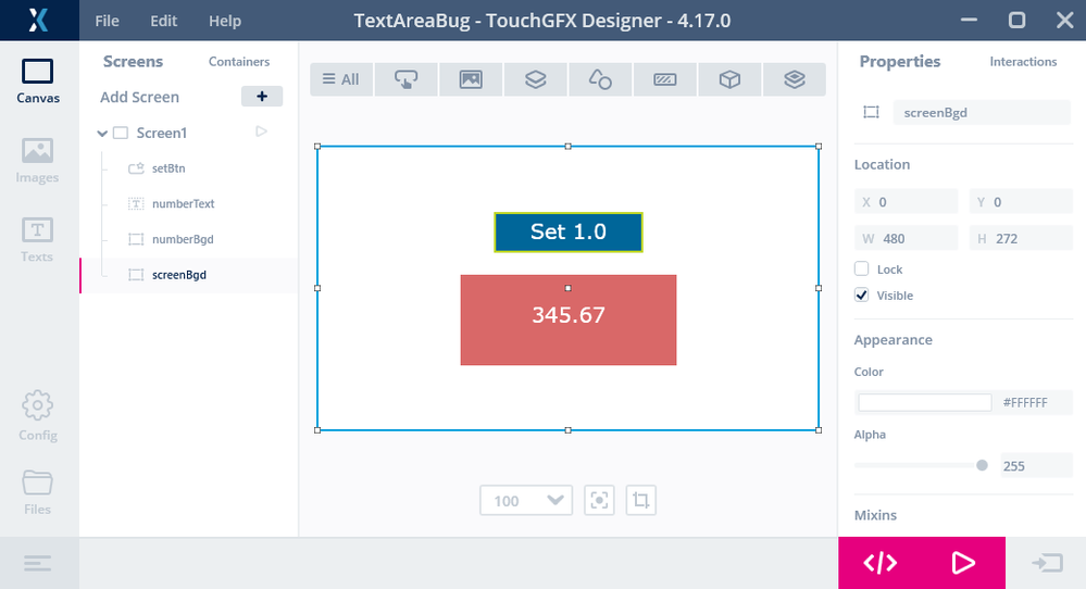

Simple Screen
The project includes a single screen with a white background, and three additional objects:
Screen Appearance

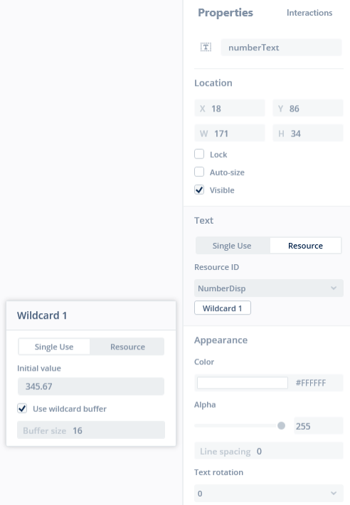

TextArea
The TextArea (numberText) is of fixed width, non-autosize, includes a buffer with a 16 character size. and has an initial setting og 345.67:

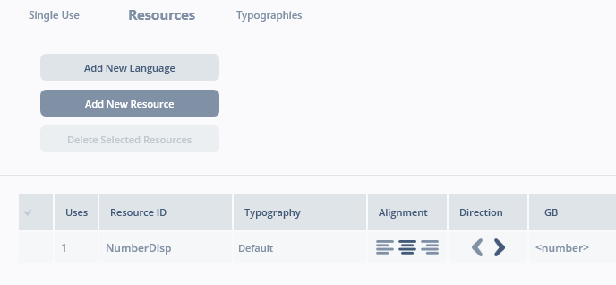

Text Resource
The text resource (numberDisp) specifies the default font, centered display, and single wildcard (<>):

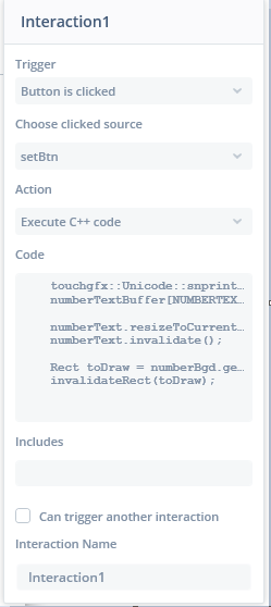

The screen defines an interaction for a click on the setBtn to execute inline C++ code:

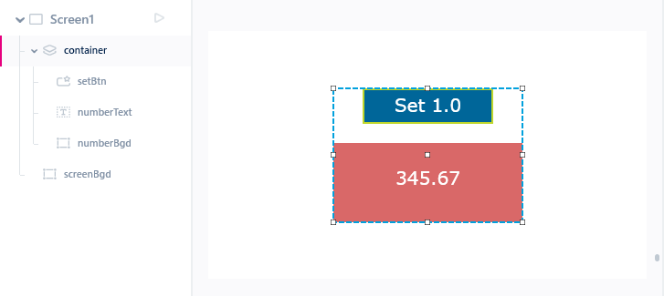

But now, in order to make reorganization of the screen easier, we decide to place the screen objects inside a simple container:
And then, use the same code as before to update the display:
touchgfx::Unicode::snprintfFloat(numberTextBuffer, NUMBERTEXT_SIZE, "%.2f", 1.0f);
numberTextBuffer[NUMBERTEXT_SIZE-1] = 0; // ensure string termination
numberText.resizeToCurrentTextWithAlignment();
numberText.invalidate();
Rect toDraw = numberBgd.getRect();
invalidateRect(toDraw);But, we once again see the problem of “residue�? of the original contents of numberText remaining on screen.
Scenario 4: Text Replacement Success
Finally, extrapolating the idea that appeared to fix the issue in the first case, we add code to also invalidate the container as well:

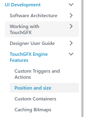

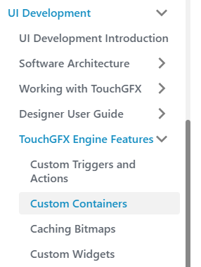

As it turns out, in my post, I failed to include the fact that we're operating in version 4.17 of TGFX---the version is fixed by my client's policy during phase 1 of the development effort. And, in fact, the documentation reference you provide, which clearly explains the issue here, was not present in 4.17 documentation, at lease not in the place it occupies in the 4.20 document ("Position and Size"), and not anywhere that I could locate by searching in 4.17:
4.20 Documentation
4.17 Documentation
So, finally, all's well that ends well. And, when my current client or a future client selects 4.20 (or whatever then is the current version), I promise once again to go over the docs to make sure I'm aware of all the new information and nuance that has been added.
