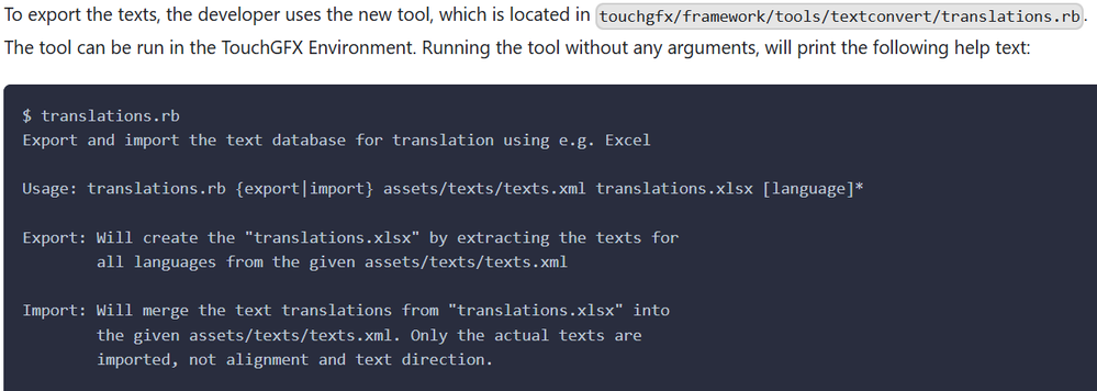

the documentation says
"The tool [translations.rb] can be run in the TouchGFX Environment."
What is meant by "TouchGFX Environment" ?
What does the dollar $ sign represent ? Is it a ruby interpreter ? Or some TouchGFX command line tool ?
Thank you

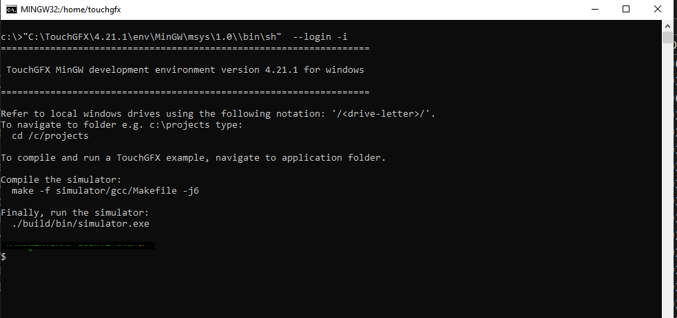

2023-02-06 8:55 AM
Crystal clear, Thanks.
This helped to understand how to run it from command line
"C:\TouchGFX\4.21.1\env\MinGW\msys\1.0\\bin\sh" --login -i2023-02-07 12:07 AM
