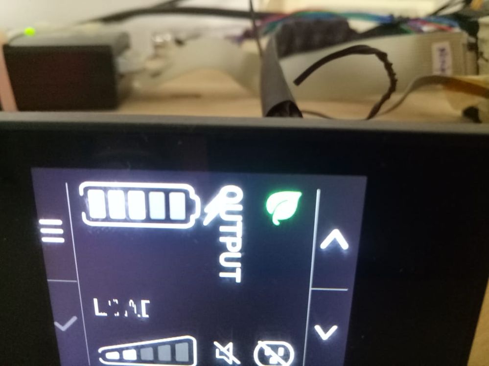

2020-11-04 11:47 PM
when I am rotating the text by 270 in setup screen() . From the handleTickEvent I am changing the wildcard text as well as I am also changing the position height and width though I am getting text but it is grainy...not clear(I have included invalidate() function also
Load in this Image).I tried changing alpha and various height and width but still I am getting grains.....

Can you share your code ?
Did you configure the MPU ? I had the same problem and now it is solved thanks ur
Here are some examples given by ST employee; just call this function in your main. Maybe it will need your modification - depends on frame buffer location !

2020-11-05 10:13 PM
Yes I have Included MPU_config in main()....
The function is

MPU_InitStruct.IsCacheable = MPU_ACCESS_NOT_CACHEABLE;
MPU_InitStruct.IsBufferable = MPU_ACCESS_NOT_BUFFERABLE;
HAL_MPU_ConfigRegion(&MPU_InitStruct);
/** Initializes and configures the Region and the memory to be protected
MPU_InitStruct.Enable = MPU_REGION_ENABLE;
MPU_InitStruct.Number = MPU_REGION_NUMBER4;
MPU_InitStruct.BaseAddress = 0xD0000000;
MPU_InitStruct.Size = MPU_REGION_SIZE_32MB;
MPU_InitStruct.SubRegionDisable = 0x0;
MPU_InitStruct.TypeExtField = MPU_TEX_LEVEL0;
MPU_InitStruct.AccessPermission = MPU_REGION_FULL_ACCESS;
MPU_InitStruct.DisableExec = MPU_INSTRUCTION_ACCESS_DISABLE;
MPU_InitStruct.IsShareable = MPU_ACCESS_NOT_SHAREABLE;
MPU_InitStruct.IsCacheable = MPU_ACCESS_CACHEABLE;
/* Enables the MPU */
HAL_MPU_Enable(MPU_PRIVILEGED_DEFAULT);
}Gui code
void normal_screen_hView::setupScreen()
ticks = 0;
item_index = 0;
load_index = 0;
item_TypedText = T_INPUT;
normal_screen_hViewBase::setupScreen();
layoutScreenBase();
refreshScreen(presenter->getScreenInfor());
void normal_screen_hView::refreshScreen(LCD_screen_t *LCD_screen)
uint16_t i;
Normal_t normal;
switch(normal.index)
case NormalMenuIndex_INPUT_VOLTAGE:
Unicode::snprintf(normal_item_textBuffer, 30, "%s", TypedText(item_TypedText).getText());
break;
case NormalMenuIndex_OUTPUT_FREQUENCY:
item_TypedText = T_OUTPUT;
break;
case NormalMenuIndex_OUTPUT_VOLTAGE:
break;
case NormalMenuIndex_RUN_TIME:
item_TypedText = T_RUNTIME;
break;
default:
break;
item_text.invalidate();
load_text.setTypedText(TypedText(T_LOAD));
load_text.invalidate();
void normal_screen_hView::layoutScreenBase()
icon_battery.setBitmap(Bitmap(BITMAP_BATTERY_03_WHITE_H_ID));
icon_battery.setXY( battery_icon_pos.y,
CONTAINER_SISE - battery_icon_pos.x - icon_battery.getHeight());
container.add(icon_battery);
icon_load.setBitmap(Bitmap(BITMAP_LOAD_02_H_ID));
icon_load.setXY(load_icon_pos.y,
CONTAINER_SISE - load_icon_pos.x - icon_load.getHeight());
container.add(icon_load);
icon_audio.setBitmap(Bitmap(BITMAP_ICON_AUDIO_OFF_H_ID));
icon_audio.setXY( audio_icon_pos.y,
CONTAINER_SISE - audio_icon_pos.x - icon_audio.getHeight());
container.add(icon_audio);
icon_plug.setBitmap(Bitmap(BITMAP_ICON_PLUG_OFF_H_ID));
icon_plug.setXY(plug_icon_pos.y,
CONTAINER_SISE - plug_icon_pos.x - icon_plug.getHeight());
container.add(icon_plug);
icon_charging.setBitmap(Bitmap(BITMAP_ICON_CHARGING_WHITE_H_ID));
icon_charging.setXY(charging_icon_pos.y,
CONTAINER_SISE - charging_icon_pos.x - icon_charging.getHeight());
container.add(icon_charging);
icon_status_online_green.setBitmap(Bitmap(BITMAP_ICON_STATUS_ONLINE_GREEN_H_ID));
icon_status_online_green.setXY( status_online_green_icon_pos.y,
CONTAINER_SISE - status_online_green_icon_pos.x - icon_status_online_green.getHeight());
container.add(icon_status_online_green);
item_text.setPosition(75,12,46,226);
item_text.setColor(touchgfx::Color::getColorFrom24BitRGB(204, 204, 204));
item_text.setLinespacing(0);
item_text.setRotation(TEXT_ROTATE_270);
normal_item_textBuffer[0] = 0;
item_text.setWildcard(normal_item_textBuffer);
item_text.setTypedText(TypedText(T_NOR_ITEM));
container.add(item_text);
load_text.setPosition(155,12,31,150);
load_text.setColor(touchgfx::Color::getColorFrom24BitRGB(204, 204, 204));
load_text.setLinespacing(0);
load_text.setRotation(TEXT_ROTATE_270);
normal_load_textBuffer[0] = 0;
load_text.setWildcard(normal_load_textBuffer);
load_text.setTypedText(TypedText(T_NOR_LOAD));
container.add(load_text);
I am calling refresh screen function from handle tick event....(For every 2 seconds)
2020-11-06 2:11 AM
Thanks a lot! It worked....
2020-11-06 2:19 AM
Hmm you have to test with different MPU configs (i gave you more than one configuration but I agree that is was not clear).
Just select one config between two
HAL_MPU_ConfigRegion(&MPU_InitStruct);because currently you are just testing the last configuration of the 5 configurations i gave you.
For me, this configuration fixed my problem (especially the MPU_ACCESS_NOT_BUFFERABLE value) :
MPU_Region_InitTypeDef MPU_InitStruct = {0};
/* Disables the MPU */
HAL_MPU_Disable();
// AXI SRAM
MPU_InitStruct.Number = MPU_REGION_NUMBER0;
MPU_InitStruct.BaseAddress = 0x24000000;
MPU_InitStruct.Size = MPU_REGION_SIZE_512KB;
HAL_MPU_Enable(MPU_PRIVILEGED_DEFAULT);You can also try to invalidate the whole background and check if it solve the issue.
Can you tell me why Normal_t normal is not initialized ? do you always go in the default case ?
Can set a breakpoint on item_text.invalidate(); line code and check if you are going to display the correct string ?
regards,
Ajt
[EDIT]
I had internet issue at work so i couldn't send this answer. Can you explain which configuration made your project work ?
2020-11-06 2:25 AM
Greetings,
Configuration 2 worked for me....that Normal_t is declared in other C file. I understood what u are trying to explain....Thanks a ton for your timely help.
Thanks and Regards
Rishikesh G
2020-11-06 2:26 AM
Greetings,
Thanks and Regards
Rishikesh G
2020-11-06 2:28 AM
Ok good !
Have a nice day
AJT
2020-11-06 2:30 AM
Wishing u the same!
