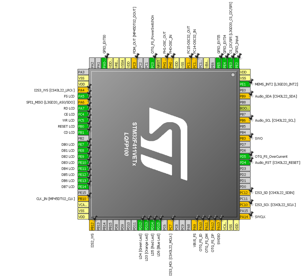

This is the discovery board stm32F411 .
2018-04-14 1:39 AM
OK but how did you connect the display to that board?
2018-04-16 1:39 AM
Hi , Sorry , i forgot the pin-map !
As you can see , on the left , there is all LCD connection.
2018-04-17 3:22 AM
So you have them in a proper order on a single port. That makes things easier.
As the bus is bi-directional, you have to change the direction of the pins between GPIO Input and GPIO Output, according to whether you are going input or output data. This is done by setting the respective bits in GPIOE_MODER - for each pin, Input is when the respective two bits are set to 0b00, and Output is when they are set to 0b01; so
GPIOE->MODER &= ~(0b0101010101010101 << 7);
GPIOE->MODER |= (0b0101010101010101 << 7);
The data output is best to be done through the BSRR register. You take your input byte, and then set (by writing 1 to the lower 16-bits of BSRR) those bits in it which are 1; and clear (by writing 1 to the upper 16-bits of BSRR) those bits which are 0; so it's something like:
GPIOE->BSRR = (byte << 7) + (((~byte & 0xFF) << 7) << 16);
