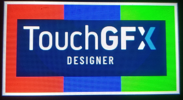

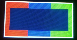

Below is the problem I encountered:
(Here are 2 images to displayed, RGB background image and Logo image.)
1) Touchgfx simulator:
2) Keil Project Effect:
3) Iar Project Effect:
I used STM32CubeMX + TouchGFX Designer V4.17 to generat code, all the codes are the same except scatter load file:

As A matter of fact, I have debugged the program in Keil, but this kind of problem occurred when I transplanted it to Iar, which puzzled me very much.
2021-07-20 12:00 AM
Hi Romain,
A bug was found in my IAR flashloader, issue was settled when fixed it.
Thank you!:beaming_face_with_smiling_eyes:
