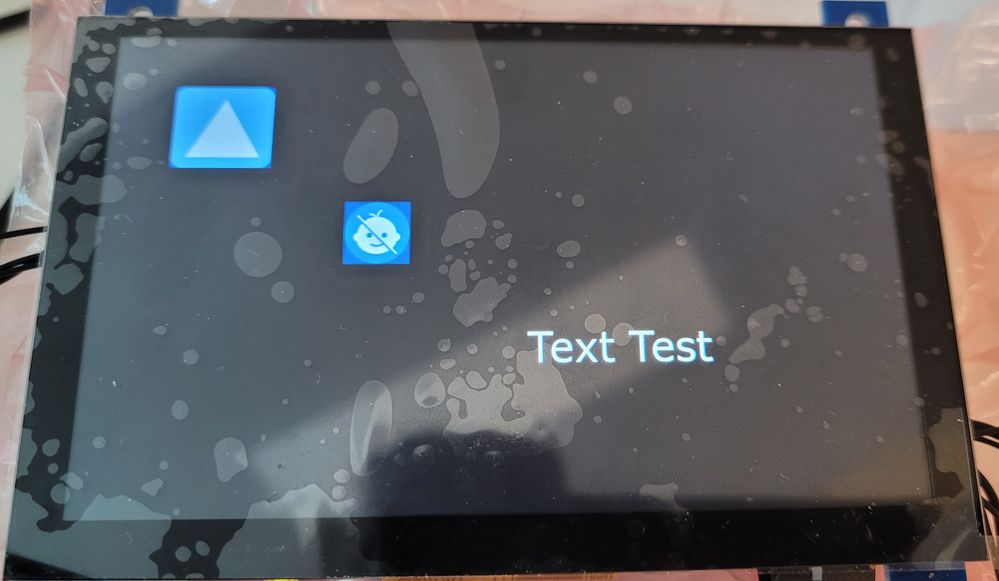

I'm experiencing a strange horizontal ghost/stripe effect mostly on light images (it's very visibile in text)
What could it be?
I'm using the STM32H7S78 microcontroller

Hello @nico23 ,
It looks like the issue doesn't only happen on text but also on the left of the flags.
Are you using a custom board or are you using the STM32H7S78-DK?
Regards,
2025-05-21 1:46 AM
Yes, it seems the issue happens on white/very bright pixels mostly
Yes, it's a custom board. These are the configurations for the display

2025-05-21 2:06 AM
Which is basically proof that this is EMI / bandwidth related - the sections with the greatest signal contrast shows the greatest interference.
Display cable too long, or of insufficient quality ?

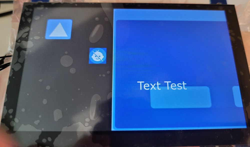

2025-05-22 12:02 AM
Hi @Ozone
I've done other tries.
It turnes out the issue appears when I use a full background image. When there's no background image, no issue is detected. Please see below
2025-05-22 1:28 AM
Hello @nico23 ,
Did you add an image or a box?
Can you try to add a box as a background? Try different colors.
What part of the display do you invalidate?

2025-05-22 1:33 AM
Hi @GGODA
the background is an image.
In the latest two images, I've just generated the code. No user code is added.
I'll try with a box as background
2025-05-22 2:17 AM
I am not a hardware expert, but besides of external (cabling) issues, the display itself might be of low quality.
I very well remember "old" times, about a decade ago or more, when prolonged use of a terminal with static content did "burn in" this image, and a shadow of said image remained when the content changed.
This was very common with displays and operation terminals on industrial machinery running 24/7.
For a test, you could try vertical bars of different contrasts (colors) and width, to check the display visually.
A simple example would be black/white or blue/yellow.
I wouldn't be surprised if the visibilty of this bleed-over effect increases with change in magnitude of the individual pixel components (R/G/B).
2025-05-22 4:36 AM
I did not want to assume a cheap display but that is also what it made me think of.
We could verify whether it is the display's fault by trying the same GUI on a different display if you have one.
Regards,
2025-05-22 6:43 AM
Well, there is still the possibility of insufficient cabling, or you don't meet the requirements / specificiations of the display. Even an inappropriate power supply (for the display) can cause issues.
I would consult the responsible hardware guy, assuming you have one (and it is not you ...).
