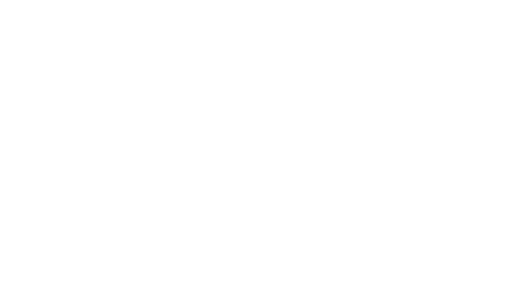

The new version of TouchGFX (V4.21.0, V4.21.1) displays the text of a Button With Label no more vertical centered. In the designer the text is shown correctly, but in the simulator and in the compiled controller application it is positioned too high.
Is there a way to correct the position?
Screenshot with TouchGFX 4.20.0
Screenshot with TouchGFX 4.21.1

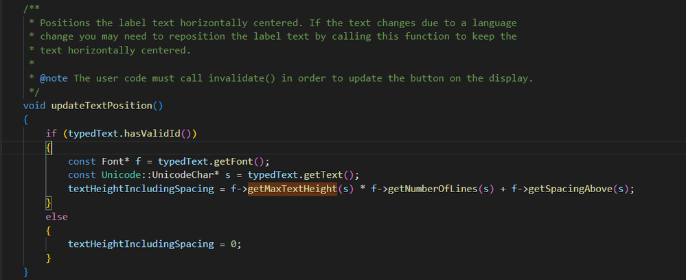

If you want to get the same behavior as before, you can modify the updateTextPosition() inside the touchgfx\framework\include\touchgfx\widgets\ButtonWithLabel.hpp file inside your project.
You can modify text height spacing by replacing getHeight() by getMaxTextHeight(), like this :

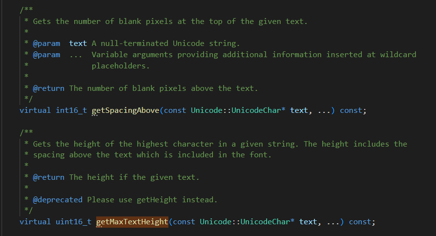

Also, since getMaxTextHeight() is now a deprecated method, you'll also have to remove the deprecation tag inside the touchgfx\framework\include\touchgfx\Font.hpp file :
