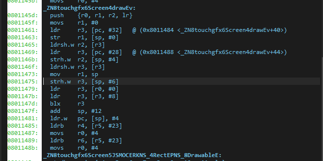

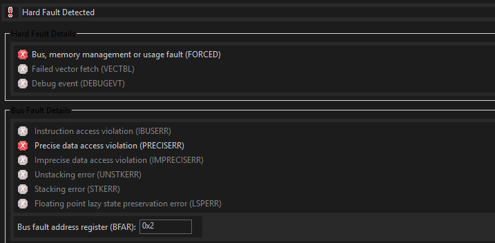

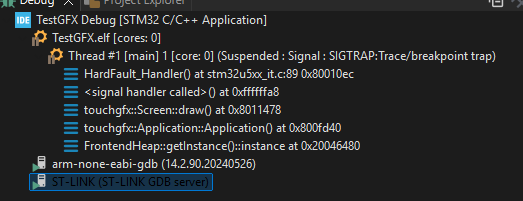

I am encountering a problem when, in the main function, the microcontroller hard faults during the MX_TouchGFX_PreOSInit function, in particular at the FrontendHeap& heap = FrontendHeap::getInstance() call.

Here are the screenshots of the hard fault info, stacktrace, and disassembly as shown by STM32CubeIde:

Hello @JacopoFurci,
In CubeMX in Computing->CRC, you cant have something different from "Default Polynomial State". But after TGFX initialization, you can change the CRC polynomial state if you want to.

Hi Louis,
that was the problem thank you. I probably changed it at some point and forgot, now it works as expected.
Thank you again for your help.
