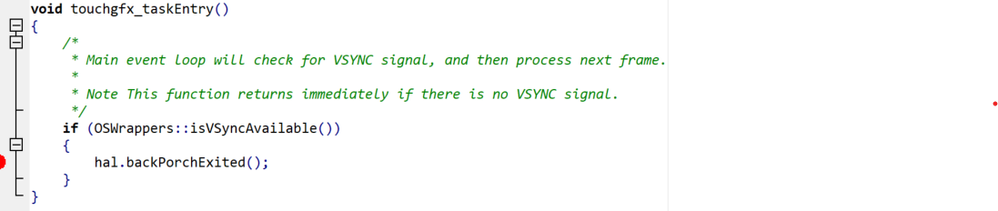

I am using stm32 303e eval , i want to display an image on the in built lcd mounted on the mcu . i am using touchgfx,cubemx and IAR workbench. In touch gfx this mcu does not appear so i started with cubemx with initial peripherals then i go to touch gfx and then to IAR workbench my code is running but nothing appears on the lcd.
ps
i am using stm32 303e eval mcu with touchgfx,cubemx,IAR workbench. since this board is not available on touch gfx i started my project with cube mx selected this board then went to touch gfx.During debugging it is not stepping into if statement provided in gpio pin configuration lcd pin is low i am using non rtos path and nothing is appearing on the screen but there is no error in the code
