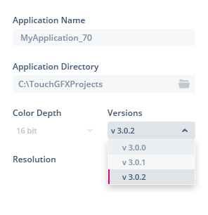

Hello @JDave.4 ,
The N6 is harder to debug than the other board in touchgfx, do you use touchgfx 4.25 and the latest board TBS (v3.0.2) ? It was updated with better debugging capabilities.
Also there's a readme.md in the root of your project that might help you, for debugging.
