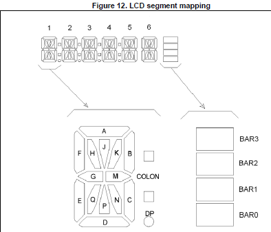

0693W000005BEQZQA4.png 0693W000005BER8QAO.pngFor example, I want to display BAR0.
According to LCD_Connection it is: LCDSEG11 to COM3

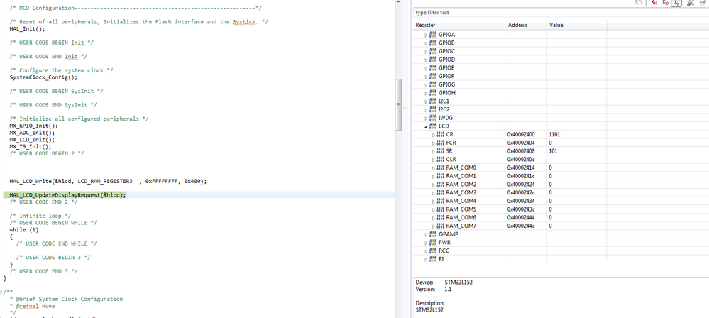

I think with this command I will change LCD_RAM_COM3 bit 11 to tru
HAL_LCD_Write(&hlcd, LCD_RAM_REGISTER3  , 0xFFFFFFFF, 0x400);
But after uploading, I look at the LCD register ... RAM_COM3 ... bit11 - but nothing is set
0693W000005BEVoQAO.pngI don't know why it doesn't work? Thank you all :smiling_face_with_smiling_eyes:

Which clock do you have selected for LCD, in RCC_CSR.RTCSEL? Is that clock enabled and running?
Unfortunately, I don't know exactly where the LCD clock is set. RAM_COM should be set anyway, but it won't set me.
Here is the RCC and LCD ini code:
