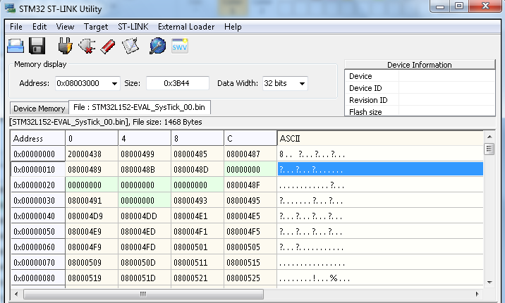

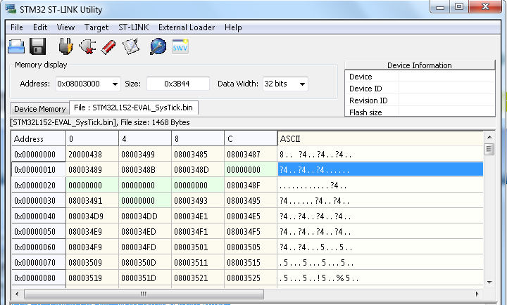

Thank you for your quick response. I thing engineers using DFU with STM32L15xx MCUs can help too.
The DFU software worked well. I believe they did what they should do.It is just the VCP does not work at all. The PC cannot recognize the VCP any more. What I notice that content of the binary files with address 0x08003000 and 0x08000000 are different. Will that be the reason why it did not work?Below are the binary files opened with STM32 ST-LINK Utility. They are compiled with IAR Workbench. You can see there are many difference even they both let the LED toggled the same way.2013-10-25 11:13 AM

SysTick_00 is not built for 0x08003000 operation, note the addresses in the vector table.
It is critical that the linker build the image for 0x08003000 (or whatever the basis needs to be). Your second example appears to meet that criterion. Can you be more specific about the .H files with absolute addresses? It is the linker, via linker scripts, or scatter files, that determines where the code gets situated.2013-10-25 1:03 PM
I can tell the address are different from the vector table. But interestingly, they both worked if I debug them directly with IAR Workbench.
