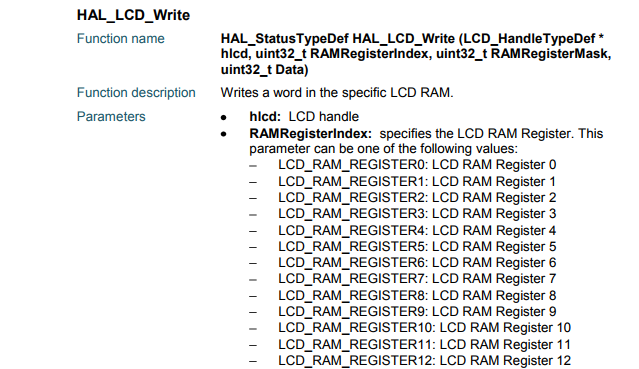

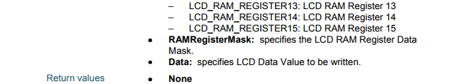

HAL_LCD_Write function writes to the LCD RAM memory:
HAL_StatusTypeDef HAL_LCD_Write (LCD_HandleTypeDef * hlcd, uint32_t RAMRegisterIndex, uint32_t RAMRegisterMask, uint32_t Data)
You can have a look to the
User Manual Description of STM32L0 HAL and Low Layer driversBest Regards
Imen

As Imen pointed out above, HAL_LCD_Write() does not perform any seg/com decoding, it simply writes to one of the LCD module's RAM positions, refer to the LCD chapter in RM.
But the mapping is pretty straighforward: pixels (segments) corresponding to COM0 are in RAM[0] and RAM[1] (i.e. COM0SEG0 is bit 0 in RAM[0], COM0SEG1 is bit 1 in RAM[0] etc.), COM1->RAM2 and RAM3, etc.
