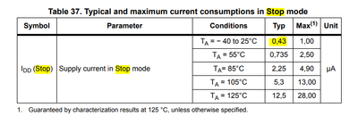

@PSaga.1 wrote:now observed that the power consumption is 0.44 u amps ... but this current feels very low is it correct? .
LOL - don't often get people complaining that their sleep current is too low !
Anyhow, what does the Datasheet say?
2025-01-24 2:16 AM
Hello @PSaga.1,
Normally, using an STM32L073, the typical power consumption is 0.43µA as per the datasheet:
