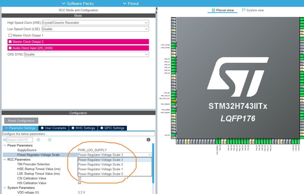

Hi
unfortunately, I Have same issue. I test both PWR_EXTERNAL_SOURCE_SUPPLY and PWR_LDO_SUPPL. of course, PWR_LDO_SUPPLY is the proper option. In both conditions debug crashes when the code reaches to SystemClock_Config.
I use CubeMX 6.7.0
I change
__HAL_PWR_VOLTAGESCALING_CONFIG(PWR_REGULATOR_VOLTAGE_SCALE1);
to __HAL_PWR_VOLTAGESCALING_CONFIG(PWR_REGULATOR_VOLTAGE_SCALE2);
and the problem is solved. I don't understand the reason.
is it true the way that I did?
another problem is that PWR_REGULATOR_VOLTAGE_SCALE2 doesn't exist in cubeMX so I have to adjust the config after each code generation.
Also, I faced with a crash when the code reach to MX_LTDC_Init function.
any Idea?

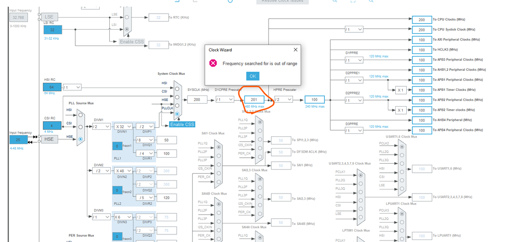

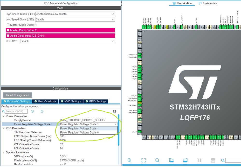

2023-02-09 2:27 AM
also, I create two different cubeMX files and encounter two different menu
also, the clock configuration doesn't get a clock speed of more than 200Mhz. I attached an image to clarify problem.

That is definitely strange. Could you create a new post about your issue to have more visibility ?
Can you confirm the two projects are created from scratch and have the same configurations but show different options now.only for the power voltage scale.
/Romain
2023-02-19 2:02 PM
The value of the "SupplySource" setting differs in those same screenshots... And the "Product revision" setting also has an impact on the maximum frequencies.
