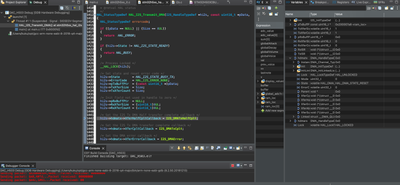

I'm about to program a continously running DMA stream (using GPDMA1 (circularly))  in an STM32H503CBU6. But the start already fails.
during the setup of the i2s->hdmatx pointer is zero causing the crash when it wants to get initialized.
I'm in need of a running example with an I2S device configured with a continously running DMA write stream
with a length of 1 (32 word) to the I2S device. Help urgently needed, please.

Set up a GPDMA channel to service I2S2_TX requests. You don't have one assigned.

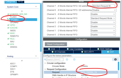

Please include your IOC file. The DMA pointer should get initialized in the mspinit function. Needs to be enabled in the IOC.
IOC file attached.
Ah, thanks. I see "Request configuration", there is SPI2_TX/I2S2_TX !
I'll try to get further.  Only about the mode I'm not sure. Wouldn't I have to choose circular mode when the DMA should keep itself ongoing?
Yes, if you want it to continue forever you will need to enable circular mode.
