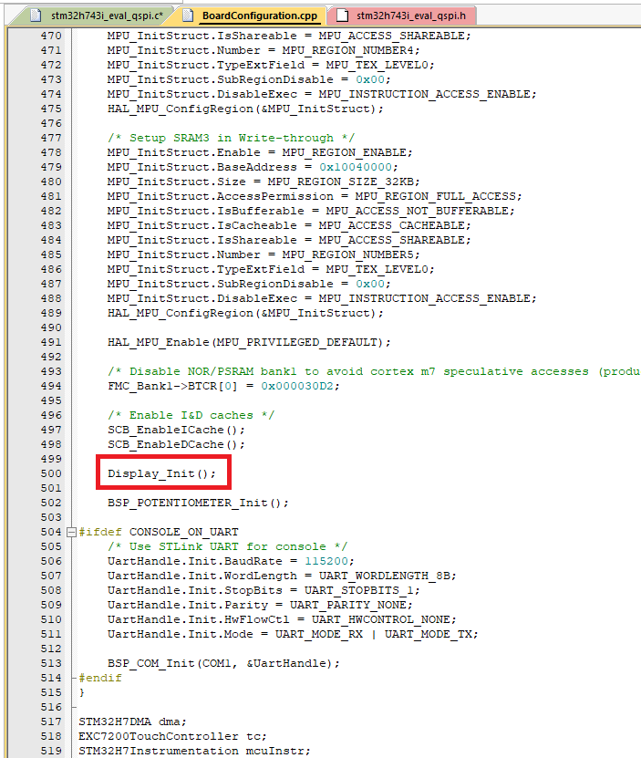

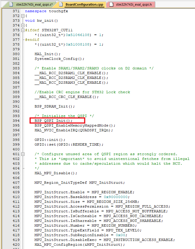

I think we're discussing something similar in another thread. Are you saying that neither QSPI_Init() or Display_Init() are being called?
/Martin
2019-05-20 1:32 AM
Yes it only call
QSPI_Init()
Display_Init()
So LCD only light but no data read from QSPI.

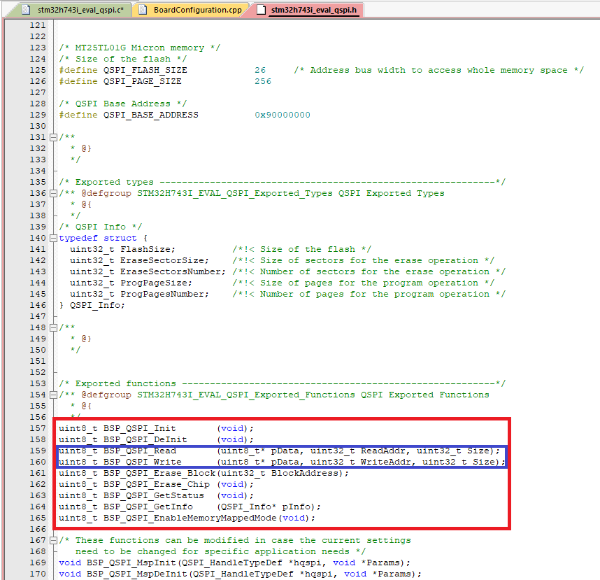

So I wanto know Where should I call BSP_QSPI read() function?
2019-05-20 1:39 AM
This is not something you're supposed to do. The QSPI is memory addressable so there's a pointer to the data floating around inside TouchGFX. You'd only want to call QSPI_Read if you want to do something with the data yourself and you know exactly where assets are placed in memory.

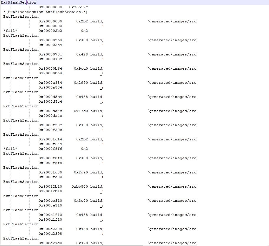

I check my demo .map file
My External flash was put in 0x90000000
Or is here any project setting I should set for QSPI?
2019-05-20 2:19 AM
This is fine. TouchGFX knows to look in the ExtFlashSection. You shouldn't have to do anything. There must be something else wrong. How is your TouchGFX project structured? Do you even have a screen with an image on it?
