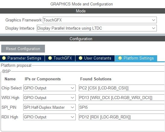

I am trying to use STM32CubeIDE for with STM32F429i DISC1 for generating code with TouchGFX enabled in Device configuration tool. I have configured Touchgfx options as shown below.
After clicking EXECUTE button in touchgfx tab, touchgfx window opens.
