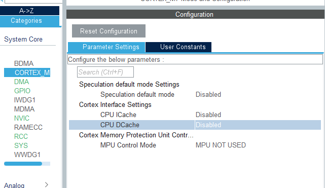

2022-06-22 7:06 AM
Hi, @Imen DAHMEN
I made the necessary changes in the STM32H743ZITX_RAM.ld file and the DCcache option in STM32CubeIDE was already disabled.

I also changed the order of these:
MX_DMA_Init();
MX_DCMI_Init();
I still have the same issue however of the buffer not being updated.
I am doing all this with STM32CubeIDE
