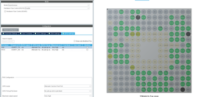

Note that you can see which pins can be used instead of PA9 in my case by clicking on the pin name in the USART setup, then pressing ctrl and then clicking on the pin on the schematics and you will see the other available pins blinking (in the screenshot below, there are 3 pins than can be used for TX) :
