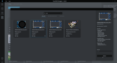

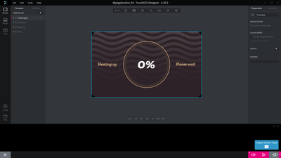

"Hello @ArunJohn ,
You should be able to create a project on the TouchGFX Designer for your STM32U5G9K-DK2 without issue.
Here are the steps:
By following this steps you should have a working demo on your STM32U5G9J-DK2.
If it not the case, double check :
Regards,

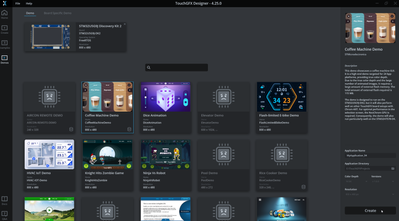

Hi @ArunJohn
"I can't seem to find the source code for it anywhere"
you can get it from GfxDesigner as explained here

The out of the box demo delivered on the board upon purchase might not be one of the demos available in Designer, we provide MCU load and some other demos such as the "map demo" on the out of the box demo.
I don't remember what is flashed by default on the STM32U5G9J-dk2.

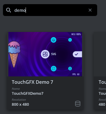

"the TouchGFX Designer demos I tried show corrupted graphics on the screen."
I tried to run Demo 7 from GfxDesigner and it works Okay on my board. Which demos are corrupted on your board ? I'll try those.

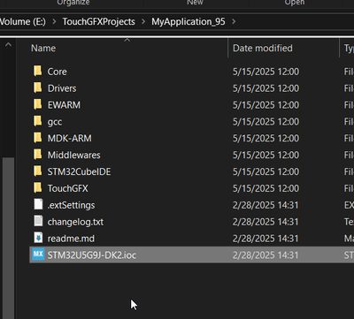

One more thing - would it be possible to also share the a sample .ioc file used for this demo project (or any similar project for this board)? I’m mainly trying to understand how the LTDC and TouchGFX middleware are configured, and having the .ioc as a reference would make things a lot easier to replicate.
Appreciate the support!
2025-05-15 3:01 AM

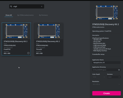

Hello @ArunJohn ,
You can just create a project using the STM32U5G9J-DK2, it uses LTDC:
Then click on the folder icon to open the file location:
And then you can navigate you level back to find the ioc file:
