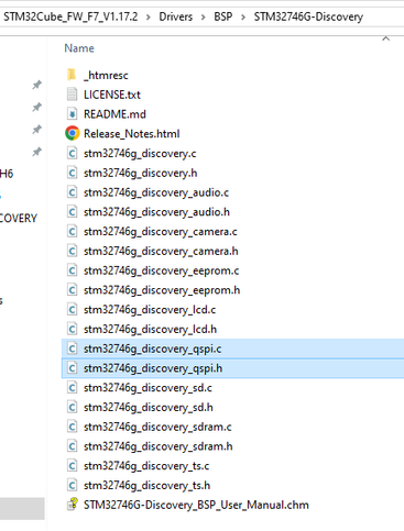

The problem why the draw function threw an error was probably that it could not get the fonts, texts and the image from the external memory, and with no data it cannot update the framebuffer. Maybe it would be cool to print out some text so the user could see the problem.
What was missing was the quad spi driver, which was not the latest, and the W25Q128J QSPI memory header with all the register definitions.
If someone else has the same problem, this is what you need to do:

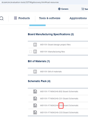

Is it really CU2 and CU4 ?
Are you sure it's not C02 and C04:
Have you checked the Bill of Materials (BoM).

It depends on which description you are looking at. If you look at the board, the description is DK32F746G$CU4, which corresponds to MB1191-F746NGH6-C03 Board Schematic. On the back of the board there is a QR code and the schematic number, which corresponds to the schematic description that ST has on their site. In the first post I made a picture of the board. You can see the description number.
The DK32F746G$CU2 corresponds to the schematic MB1191-F746NGH6-C01.
Yes, we looked in the BoM and I noticed two differences; from version MB1191-F746NGH6-C01 to MB1191-F746NGH6-C03 the LCD driver and the flash memory have been changed. My first instinct would be that the driver is not compatible with the current SW.

2024-09-06 4:49 AM - edited 2024-09-06 4:50 AM
Hello @Jackiii1989 and @Kivi,
Unfortunately, we have not made any progress yet. But, I can give you some clues while we get the time to update the TBS.
As you mentioned, the difference is only in the display and QSPI Flash, and based on the hardfault you have encountered, it is a good guess that the flash is causing the issue rather than the display.
Please download the latest firmware package for the STM32F7 family, and navigate to Drivers-> BSP -> STM32F746G-Discovery. Then, use stm32746g_discovery_qspi.c and stm32746g_discovery_qspi.h to update the same files in your project.
QSPI drivers
