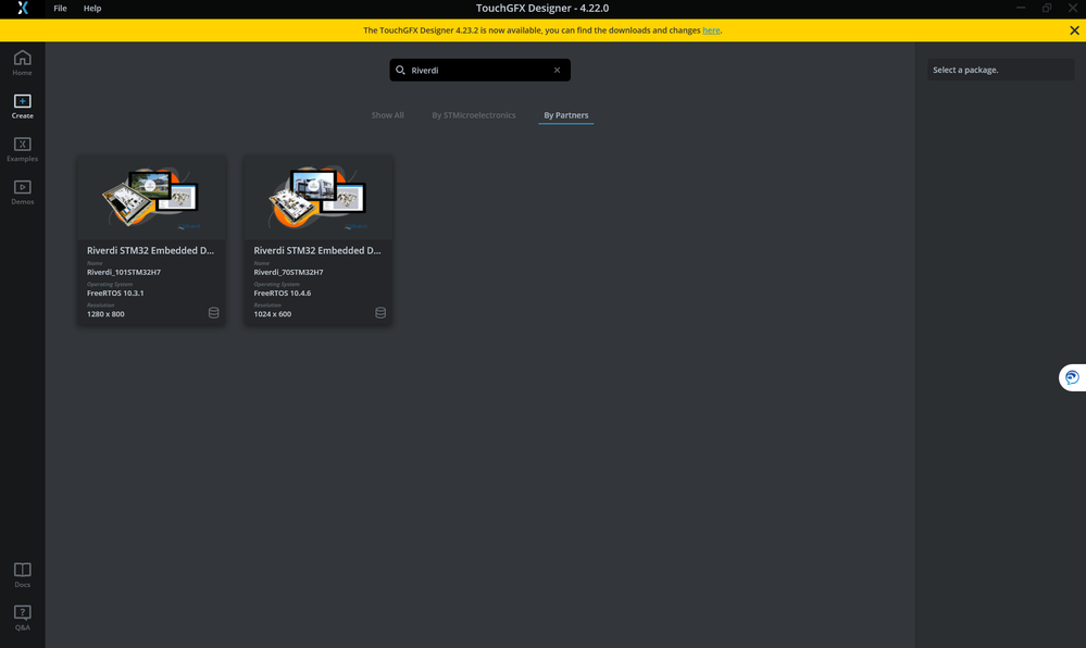

I have TouchGFX Designer 4.22.0 version installed in my PC. For my project I am using STM32U5A9NJH6Q controller with Riverdi display part number SM-RVT50HQSNWC00-B. But, in the TouchGFX Designer application I am not able to create a project because in create->By Partners i am not able to find a template for this particular display. I can only find the templae for 1280*800 and 1024*600 resolution displays for Riverdi. But not for 800*480 resolution.
Can any one please have a look in this and help me fix this issue. I have also attached in the screenshot of how my designer application create window looks.

2024-03-18 7:24 AM
Hello @Imen.D
Yes, the board was powered on. But the issue is fixed in the latest version 4.23.2.
