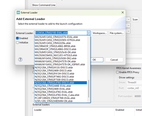

2024-03-27 6:38 AM
This fixed the workflow for me - allowing me to add images in TouchGFX Designer and compile/flash in CubeIDE - thanks!
