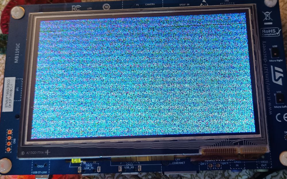

TouchGFX 4.15.0 and ST-LINK 4.6 and CubeProgram 2.6.0 installed to our system Windows 10 64Bit. Board Development STM32F746G Discovery.
I'm tring to run touchgfx samples on the STM32F746G Discovery, every thing goes well and it seems code download completed but display shows nothing but noise.

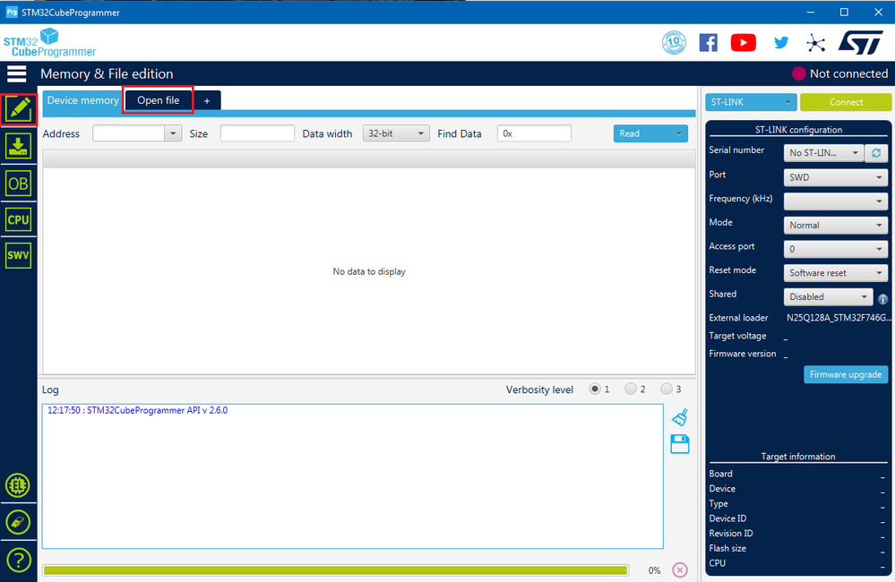

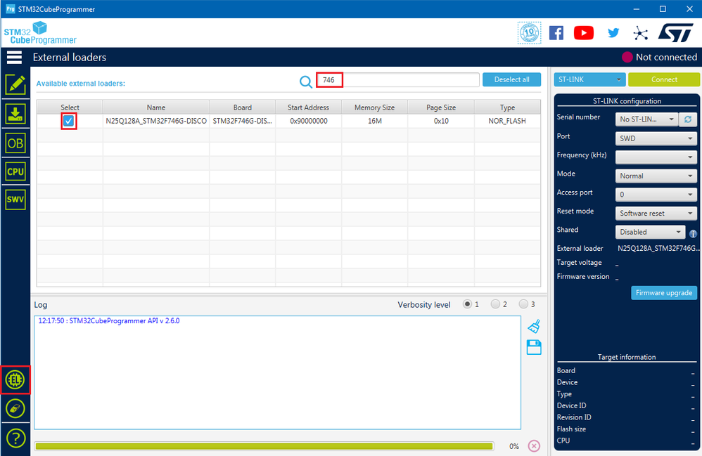

This is due to the external loader file required to program the external FLASH that contains the input bitmaps.
Try this :
For your information the path to both CubeProgrammer and external loaders are hardcoded for the Designer and I guess something is wrong in your case, you can edit them in the "<your project>/gcc/Makefile" file around line 113-114, seems like $(PROGRAMFILES) variable contains spaces.

This is a CubeProgrammer bug that was reported and is going to be fixed on next CubeProgrammer version 2.7
If using the standalone CubeProgrammer as Nicolas SANTINI explained is not a long-term solution for you, I recommend you to revert to CubeProgrammer 2.5.0 and everything should be fine :)
