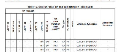

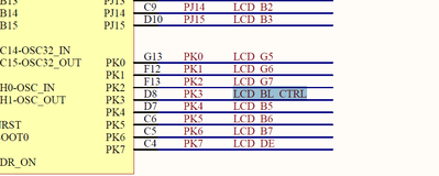

Unfortunately you cannot use PWM output with that board as the LCD_BL_CTRL control pin is connected to PK3 that doesn't support any TIM/PWM output:
Maybe you can use PWM in interrupt mode and toggle PK3 pin in it. I don't know if this is efficient.
