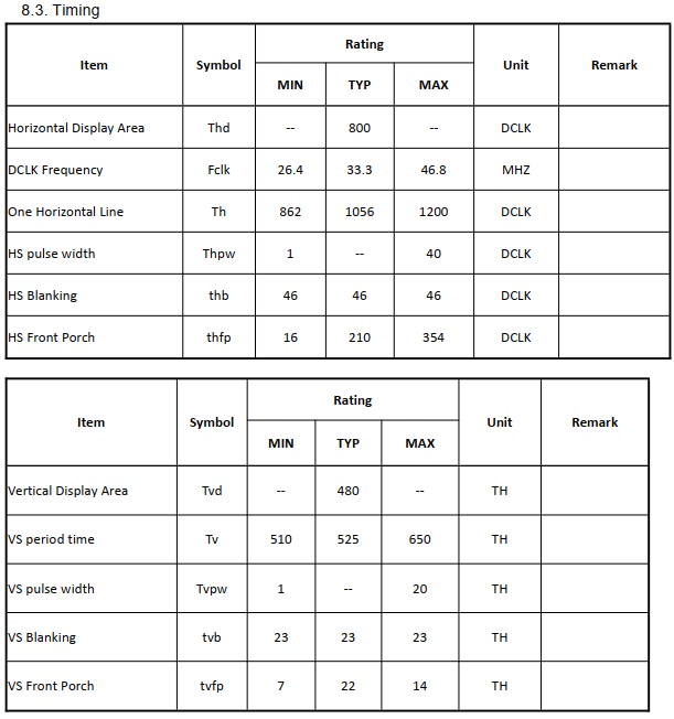

Can you explain what you did exactly? Which files you changed? And then if you have the datasheet of the display, are you sure you have the correct timing (pixel clock, vsync, hsync) configured in the LTDC peripheral?

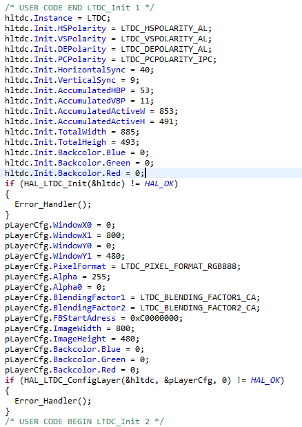

This is code i have modify:
This is TFT information
