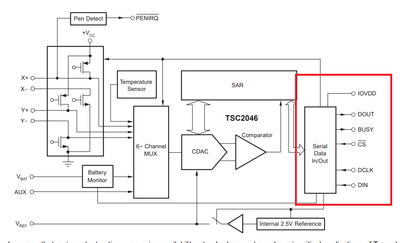

Not sure how you will do that mechanically. Is it another LCD having TSC2046IPWR controller integrated or you need to use the same LCD on the board and replace the touch screen film and replace it with another..
From electrical and programming stand point, the controller is using a serial interface mostly a SPI interface:
