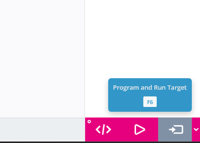

How are you flashing your board? The issue could be that you have flashed your background image to external flash previously, it has become corrupted later on, and you are only flashing the internal flash.
Using the run target button in TouchGFX designer will flash both internal and external memory:

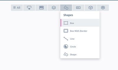

You can also verify if the issue is with the screen or the asset by placing a box:
At the top of your display, and seeing if the area covered by the box is corrupted. You can make the box draggable in the panel on the right if you want to see what happens if you move it around.

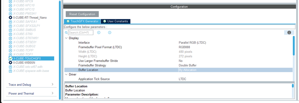

What is your framebuffer location strategy set to?
