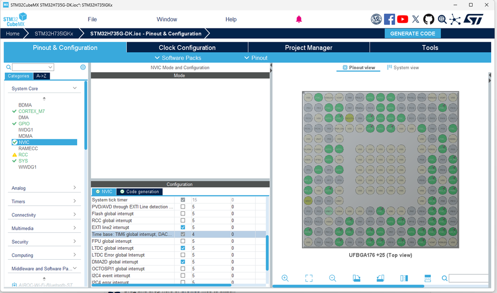

Are you running FreeRTOS?
If you are, and your timebase source under "SYS" in STM32CubeMX is a timer, the interrupt for that timer needs to have a higher priority (lower number) than LIBRARY_MAX_SYSCALL_INTERRUPT_PRIORITY, which defaults to 5, and can be configured under FreeRTOS in CubeMX. Otherwise, FreeRTOS blocks the interrupt, and your STM32 HAL timebase will not receive ticks.
I would recommend you just set the timer interrupt priority to 4, I do not know what effects changing the FreeRTOS configuration parameter would have.

2025-11-11 7:58 AM
I wrote that I would not change that setting, but change the interrupt priority instead, as per the screenshot :)
