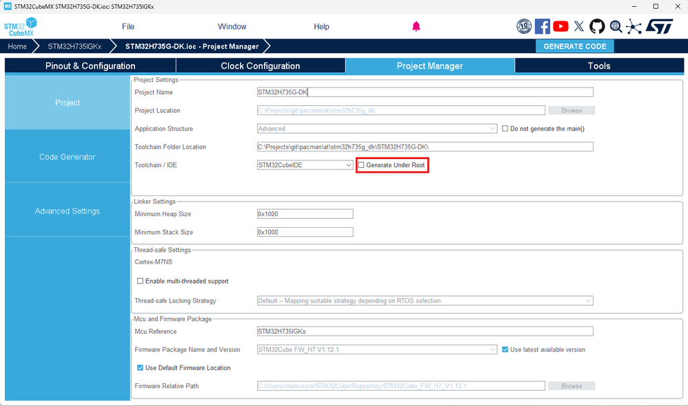

I suspect the issue is that you have this checkbox set:
TouchGFX expects the project files to be in a subfolder, which it will be if you uncheck the checkbox.

In STM32CubeIDE, that flag is fixed, you can't change it.
2025-11-11 8:05 AM
I would advise you download a standalone version of CubeMX to change that setting.
CubeMX in CubeIDE will be removed in the near future, so you will have to make the change sooner or later.
