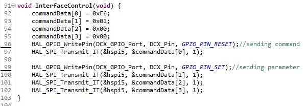

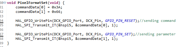

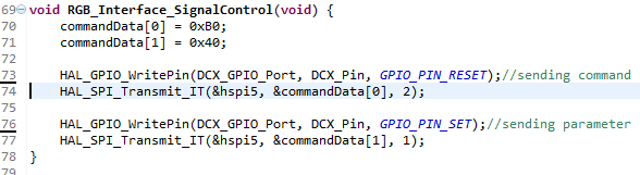

It is said in the schematic that the interface used between the STM32F429 and the display controller (the ILI9341 IC) is the 4-wire 8-bit serial I, SDA:In/Out interface. Reading the ILI9341's datasheet I found that in order to use the LTDC parallel interface it's necessary to be sent three command through this Half-Duplex SPI: RGB Interface Signal Control (B0h + 40), Pixel Format Set (3Ah + 66h) and Interface Control (F6h + {01h, 00h, 00h}). After that, I'm initializing the LTDC with the CubeMX generated code, which is suppose to make the screen blue. My code is as following:
As you can see, I'm also setting and resetting the DCX pin, according to the ILI9341 datasheet, as weel as the CSX pin.
All that said, here's the problem: it doesn't work.
What am I missing? Couldn't find something that helps me around here so far. Could anybody who made a firmware for the STM32F429I Discoery board's display help me with it?

Do you know the BSP packages ST provides for your board ?
If not, you can download a preconfigured SW4STM32 project for your board here:
http://www.dasrotemopped.de/index.php?var=cpp&nr=0
If you do not want to rely your Project on the BSP files, do yourself
a favour and write a proper driver for the ILI9341.
Did you verify that your pin toggling is in sync with the SPI Transmission with a logic analyzer ?
I had some Problems with the correct Timing between SPI5 signals and the GPIO D/C and CS.
A Bridge from Software SPI CS Pin PC2 to the Hardware CS pin PF6 may solve one Timing Problem on the F429i-disco. With Hardware CS on SPI5, you can also use DMA.

Indeed, I'm more interested in writing a proper driver myself.
I don't have access to a logic analyzer in the moment, but soon I will.
So you think it might be a sync problem? I mean, you've written a driver and came to the conclusion that there isn't any other steps besides those 3 commands and the toggling pins (with proper sync, of course)?
After I have the logic analyzer in hands and see what's happening, I'll get back here to contribute on that.
Thanks
VÃtor Pereira
2018-01-31 2:46 PM
Just have a look at the ili9341.h/.c files in the BSP Project to get an idea how the initialisation of the ili9341 should look like for the F429i-disco. Have the ili9341 datasheet close at hand to understand the steps done in the BSP driver.
